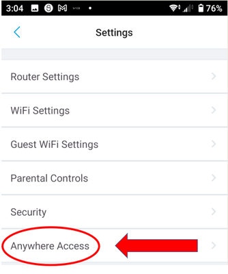

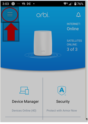

    When connected locally to the router (on the Orbi LAN), open the Orbi app.
    Then, select the menu in the upper left part of the app screen.
    Select "Settings"
    Then select Anywhere Access
