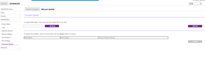

How to update firmware on satellites that do not show up on manual update tab
I have an Orbi RBR750 with two satellites. I recently updated the firmware on the RBR and now the satellites will not connect to the router. When I try to update the firmware on the satellites, the satellites do not show up on the manual update page. I've spent hours trying to fix this. Any help is greatly appreciated!

      Hi. Thanks for this suggestion. We tried this (we reverted to the previous firmware for the router), but our satellites are still unreachable. They show up on the network map and in the online portal but are "disconnected," so we can't reach them to update their firmware. They do not show up as an option when we are in the manual firmware update screen.
      There is no firmware version listed in either the app or the online portal for the satellites. That field is blank. Do you know how we can tell which firmware is on them? Is it possible they are running an even older version?
