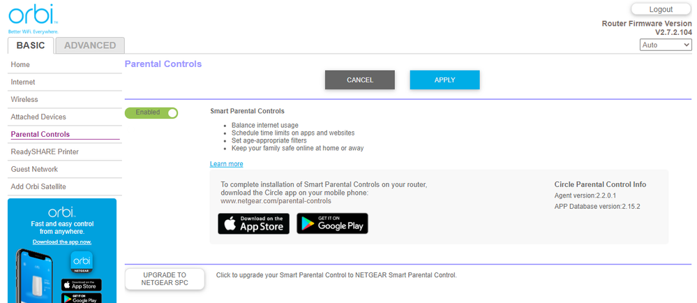

  • What version of FW are you using? if v2.7 or higher, PC is under Basic Tab now on the RBRs web page. If you enabled it there, there should be a slider button to disable it:
    • CrimpOn's avatar
      CrimpOn
      Guru
      Thanks for the response.  I am indeed on 2.7.2.104. However, I declined to activate Parental Controls and thus my home page does not include that item. (see attached).
      I have this suspicion that Android app v2.8.6.1417 is the problem. It has no was to "just say no". (pun)
