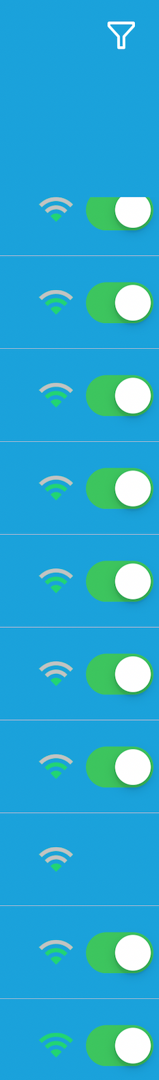

I actually have 1 RBR40 base and 3 RBS30 satellites in a 1250sq ft ranch with a basement.
I have complete coverage throughout the house. Speeds are 250mbps give or take throughout the house.
Using the Orbi app on my iPhone I see many devices with just one bar which doesnt make sense to me.
I am thinking this is why I see a little lag in my camera.
I have Daisy Chain checked.
The same thing was happening when I had Implicit Beamforming off, MU-MIMO off, and Enable Fasting Roaming off.
I am running firmware version 2.3.5.32. Just updated this morning.

Christian,
I see this from the web admin using my browser.
All show high signal strength.
Honestly I didnt think this was a representation of signal strength.
I thought it was just a picture showing all devices connected to wifi not necessary display the strength of the signal.
Every wireless device whether on 2.4ghz or 5.0ghz shows the same as the picture below.
One device should not be full strength? I do have great coverage throughout my home.
If this is an indication of signal strength why does the ORBI mobile app show varied signals for me most low strength but a few high strength?
See attachment.

- k3n85Tutor
I've seen the same, my device is 3 feet away from a connected Satellite, yet shows 1-bar of signal strength in the iOS app. I think this might be broken either on the Satellite FW or in the iOS app. I also have another open post on the "Link Rate" showing incorrectly on the iOS app with the Satellite. The two issues might be similar in root cause.
