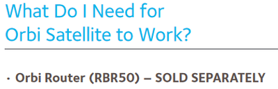

However, you may be onto something. The original RBS50 from 2016 says thisL
And the RBS50v2 satellite says this:
I have always assumed that when the original Orbi product was released back in 2016, it was the only product in the mesh WiFi portfolio. So, the only device an RBS50 could connect to was the RBR50. Netgear is not famous for going back and revising product literature.
By the time the v2 product was released, the portfolio included more mesh WiFi routers, including the RBR20 and RBR40.
Does this mean that an original RBS50 satellite cannot sync with the newer RBR50v2 router? I certainly hope not.
