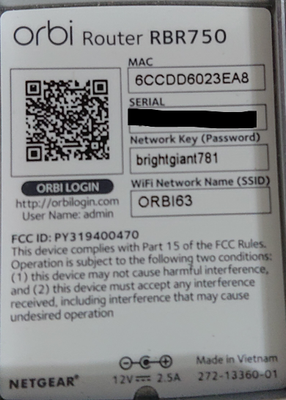

  • When Orbi routers leave the factory, they each have a default set of WiFi credentials (SSID and password). These are printed on the label on the bottom of the router.  The default SSID is the letters "ORBI" plus a two digit number, and the password is a combination of common words plus a number, such as crazymonkey23.
    That product label should also display the actual product number, such as RBR750.  (The second R standing for "Router")

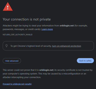

      I don't know what this means or what to do about it. I never got it before but do now after I changed the setting to use http:// on this very page.

        Modern browsers have a phobia about unencrypted web sites (http rather than https) "Not Secure. Go Back! Go Back!"
        Well, in this case, you are trying to connect to a web server that you own on your own network.  There is a link at the bottom of the page offering "proceed to orbilogin.net"  Click on that and the browser will remember and not bug you any more.
        This is the second report on the forum of an Orbi router not having a product number on it.  Is there a label on the bottom of the router?  could you take a picture of the label and post it.  (Feel free to hide the serial number)
        Here's a picture of one of my Orbi router labels
        Notice how the factory WiFi Network Name (SSID) is ORBI63 and the WiFi password is brightgiant781. (I have since changed both of them.)  The product number is RBR750
