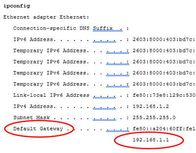

        On one of the 'wired' computers, can you determine the network gateway and attempt to connect to that IP address?
        On Windows, I open a CMD window and type: ipconfig
        In my case, the Orbi has defined the default IP address for itself: 192.168.1.1.  So I would open a web browser to
        http://192.168.1.1
