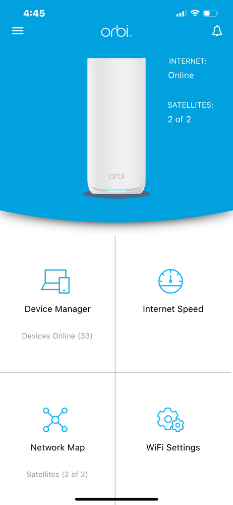

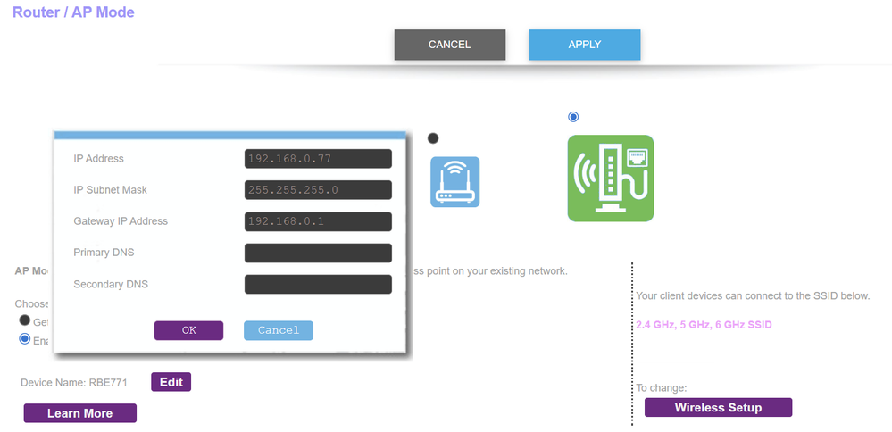

Wanted to try my 770 series in AP mode as well to see if Orbi app would connect after changing to AP mode.
CAX80 changed from modem only mode to router mode. Disabled WIFI radios.192.168.0.1 subnet on CAX80. DHCP IP address pool range .100 to .150 for my needs.
Use the following configuration on the RBR771 for AP mode:
iPhone 12 Pro Max iOS 18.5
Current released Orbi App to date.
Orbi app also is working as under Settings, Security with Armor and SPC is missing from the menu item as these are not supported in AP mode.
