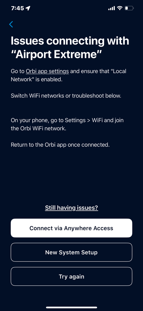

      After getting started and logged in, I did run into this screen:
      I did select Anywhere Access and it continued passed and got to the home screen successfully as seen before...Anywhere Access had been already enabled before.
  • Is there a way to enable Anywhere from the web browser? Mine fails to find an Orbi with Anywhere. I presume Anywhere was enabled when I first added my 771 because it was working at one time with the app and the web browser.
    • FURRYe38's avatar
      Would need to factory reset and set up from scratch in router mode. Then probably connect orbi app while in router mode. Should connect in local only mode then set anywhere access while in router mode with in orbi app.
