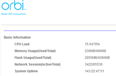

    Intermittent issues are the very devil to diagnose.  What it sounds like is that some device on the network is overwhelming the router with data packets at specific times.  It might be worth keeping a record of the CPU load reported on the Orbi 'Debug' page: (http://orbilogin.net/debug.htm
    On a scrap of paper, write down the CPU value when the system is performing well vs. when it is not.
    (The screen does not refresh automatically.  Use the 'page refresh' symbol in the web browser to update the page.)
