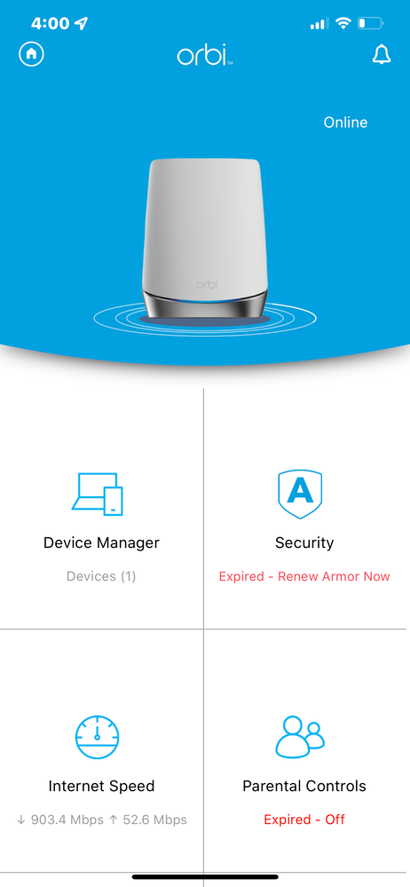

I have the Apple features disabled on my iphone and can access the RBRs web page fine:
