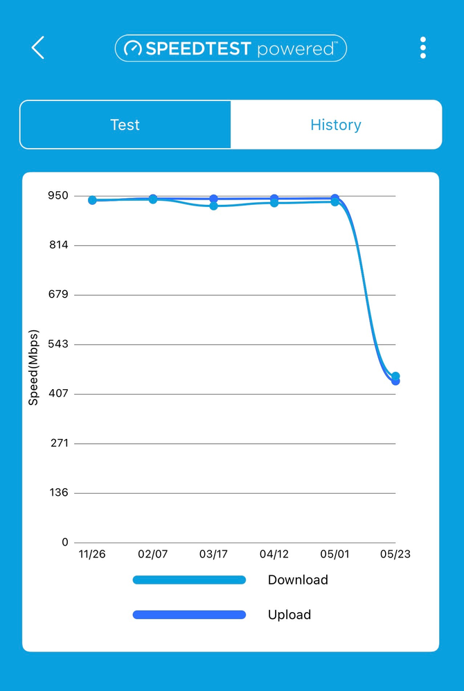

Anyone else's internet speed drop following the firmware update patch? Mine dropped by roughly half....any ideas?
