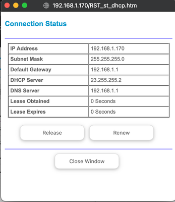

I see only ONE thing that looks weird on the Orb admin page - It reports a DHCP server at
23.255.255.2. I have no clue what this means. See screenshot.
Im stumped.

    As you have observed, the Connection Status box is incorrect.  This has been reported before and one would hope that Netgear is "working on it."
