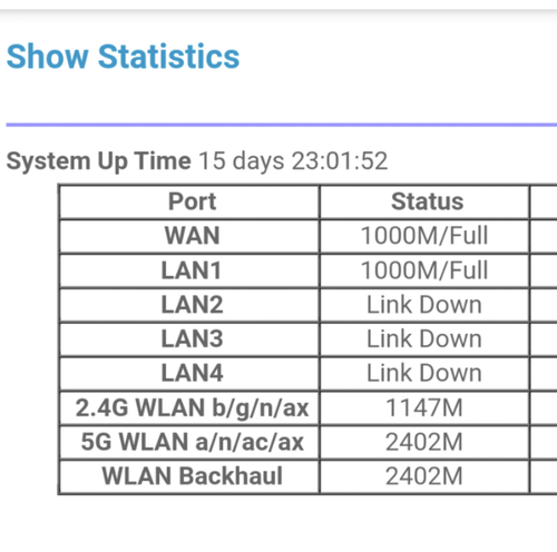

Have you checked your lan cables? Are they minimum cat 5e? Go to Attvanced and select "show statistics" what do you see? here is an example of a router and satellite connected with wired backhaul
