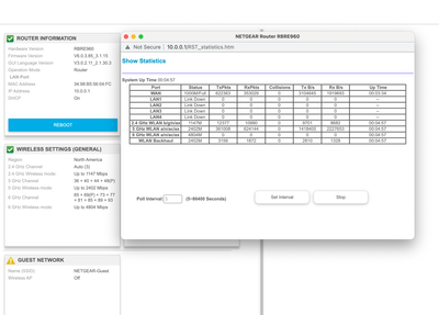

    Can you go into the Router's WebUI  (usually can be found at 192.168.1.1, but if that is not working, try 10.0.0.1), log in using admin and the password you set up for administration.   Then click on the advanced tab, find the box that says "Internet Port", click on "Show Statistics", take a screenshot, and attach that screenshot here.     (Wanting to check connection speed from router to modem).   Also let us know whether you got to the Admin Page via 192.168.1.1  or 10.0.0.1  address.

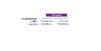

    Lastly, in the same "Advanced" tab in the Admin page, on the left, you should see "Setup" - click on that, then click on speedtest, and provide us the results of that  (this tests router to isp speed).

      7. Screen shots are below. I login through 10.0.0.1
