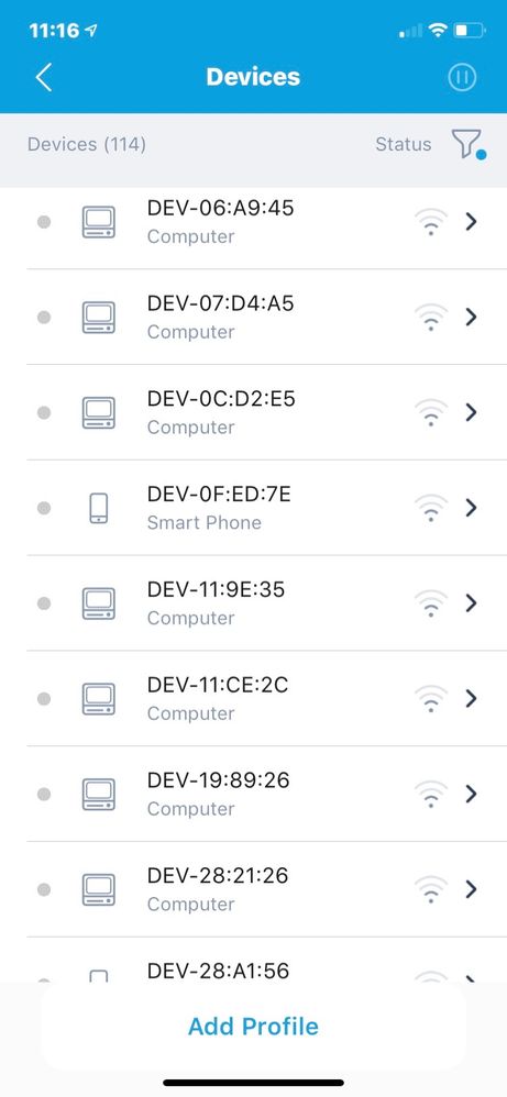

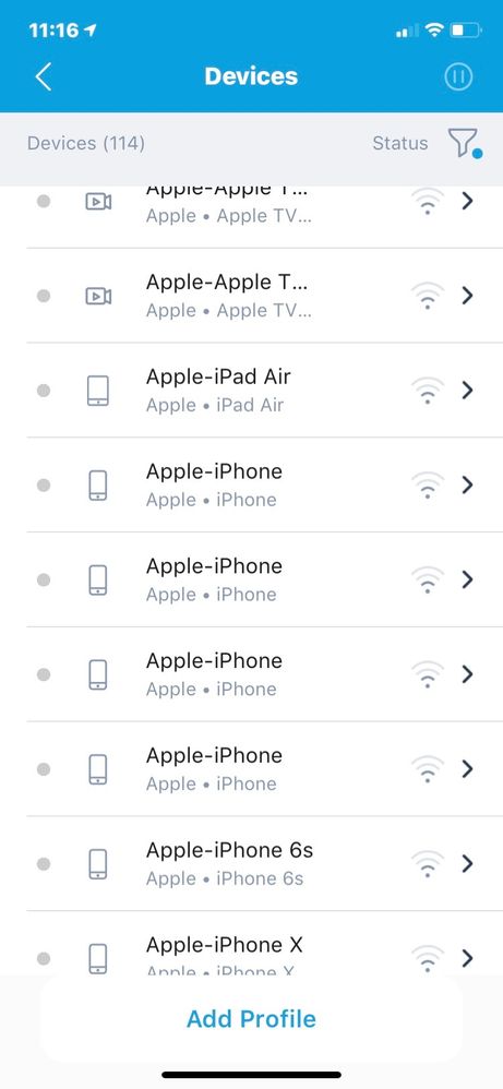

I just did the update to Firmware Version V4.6.3.7_2.0.49. Everything went through fine, but then I opened up the mobile app and saw a bunch of extra devices listed (not connected), like over 100.
On the web browser management interface, if you go into the access control page and look at " View list of allowed devices not currently connected to the network" you see devices like the below, just far fewer. Why isn't it the same list of devices? That's confusing.
DEV-4A:66:80E2:64:91:4A:66:80Wireless
All the ones in the mobile app start with DEV or they are different models of Iphones and such, there's just a lot more of them.  It appears to be all sorts of devices that Netgear had been testing with or simulating connections with.
The important thing to note is that these are in the ALLOWED devices list, so if you have enabled access control, now there's over 100 devices in that list that you didn't put there.  I've been going in and deleting them one by one. You have to tap the > for each device and then tap on delete. I would imagine under the covers there's a file somewhere you can edit via command line. If someone knows where that is, please share. I have not delved into this device much. Kind of disappointed by it really, and especially that there's no 3rd party firmware for it. Voxel only works on older models.
