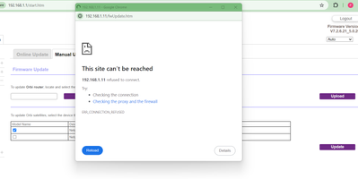

I have tried updating manually through website, this works for the rbr850, but for the rbs850 a window pops up saying connection refused.

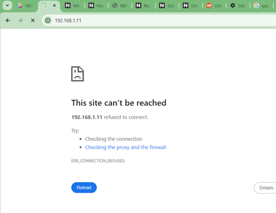

I have tried just typing the satellites IP address into the browser but nothing happens (says “could not connect to the server”)

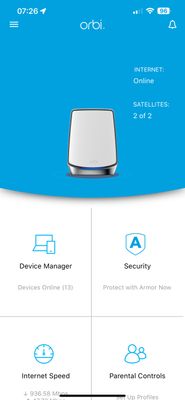

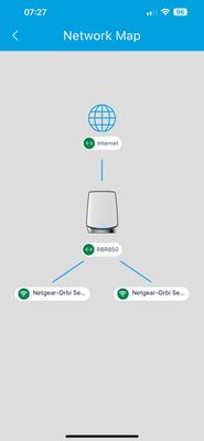

      On the app they show as connected :
      Logging into the router i can see both devices and everything seems to work. The only thing was the "Out of Sync" message which led me here.

      and when I try manual update for satellites i get this;
      And when i type the satellite IP in a browser:

      As shown in screenshots, I am not getting to a login screen, and I can't figure out why.
