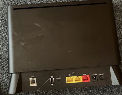

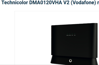

      The Vodafone DMA0120VHA appears to be a combination modem/router/WiFi device:
      It seems to have two method of connecting to the Vodafone network: DSL (the grey jack) or Ethernet (the red jack).
      How is your device connected?

      • If the device is connected using the red Ethernet port, then the most common advice would be to remove the Vodafone device entirely and plug that cable into the WAN (yellow) port on their own router (RBR350).  One of the first questions asked when configuring a WiFi router is "does your ISP require a login?"  If it does, then you need to have the user name and password to enter into the Orbi setup.
      • If the device is connected using the DSL port (grey/white?) then it cannot be removed and the situation becomes more complicated.
