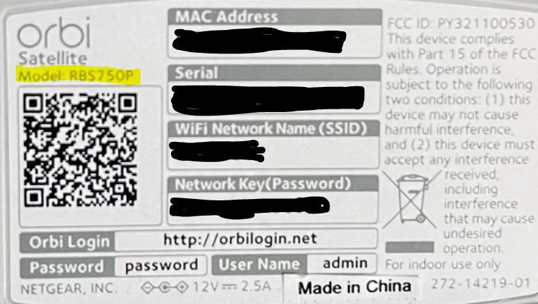

    Could you please look at the product label on one of the new satellite and verify the product number?
    (i.e. is it RBS750P or RBS760P)

      Thanks for your quick response.  I've confirmed that the product label is RBS750P. Regrettably, I've discarded the packaging for my 750P purchase and Best Buy will not accept the return.    I just didn't anticipate this kind of compatibility problem with this family of products.
      • FURRYe38's avatar
        Seems that the 750P series is from a 350 series hardware, thus this sepecific version of RBS and FW is not compatible. You'll need to downgrade the RBR750 back to prior working version of FW for the P series kit, RBR and RBS.
