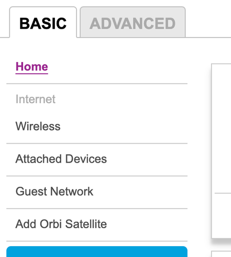

Can't change IP address for my RBR850..?
So my problem is that my Orbi RBR850 is only giving me speeds of 8/9mbps second, but I've come accross this solution to change my routers IP so that it does not conflict with my modem. However, when ...

> [...] I'm not able to select the "internet" tab [...] as it's grayed
> out and not clickable.
Is your RBR850 configured as a wireless access point? That would
explain the grayed-out Internet settings. It would also make some sense
if your RBR850 is connected to some other router.
explain the grayed-out Internet settings.Thanks, yes it is in AP mode. Would router mode unlock those setting or do I need to directly connect via ethernet cable?
It would also make some sense if your RBR850 is connected to some other router. In that case, your external/public IP address would be controlled by your actual router ("my modem") and your ISP.
Its connect to the NBS AT&T BGW-320 500. But wouldn't the IP Passthrough mode negate it as acting as a router? That was my understanding but could be very wrong.

actual problem.Based on that same link I shared, again here, the problem I'm having was solved in that post. Hence, my post is was directed at acheiving that specific solution. Heres some more effort though... Trying to solve for slow speeds of 8/9mbps on the wifi via my Orbi RBR850 which is connected to my NBS AT&T BGW-320-500, which is set to IP Passthough with Wifi off. Speeds coming into my NBS AT&T BGW-320-500 are 900/1000mbps.

IP Pass thru on the ISP modem is not needed nor recommended if you have the Orbi RBR in AP mode. If your in AP mode then there is no firewall present if your using IP pass thru on the modem. You can change the Orbi to router mode then continue to use IP Pass thru. Then you can also change the RBR IP addressing scheme as well.
AP mode you can use either Dynamic IP addressing which the RBR in AP mode will get an IP address from the ISP Modem, OR, set a Static IP address while in AP mode ON the RBR, to some address that is outside of the ISP modems DHCP IP address pool, not with in the pool.
