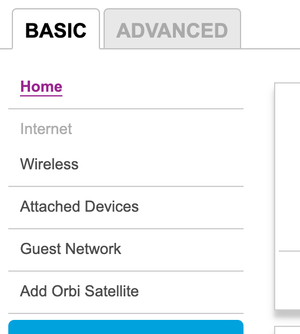

Can't change IP address for my RBR850..?
So my problem is that my Orbi RBR850 is only giving me speeds of 8/9mbps second, but I've come accross this solution to change my routers IP so that it does not conflict with my modem. However, when ...

> [...] I'm not able to select the "internet" tab [...] as it's grayed
> out and not clickable.
Is your RBR850 configured as a wireless access point? That would
explain the grayed-out Internet settings. It would also make some sense
if your RBR850 is connected to some other router.
Thanks, yes it is in AP mode. Would router mode unlock those setting or do I need to directly connect via ethernet cable?

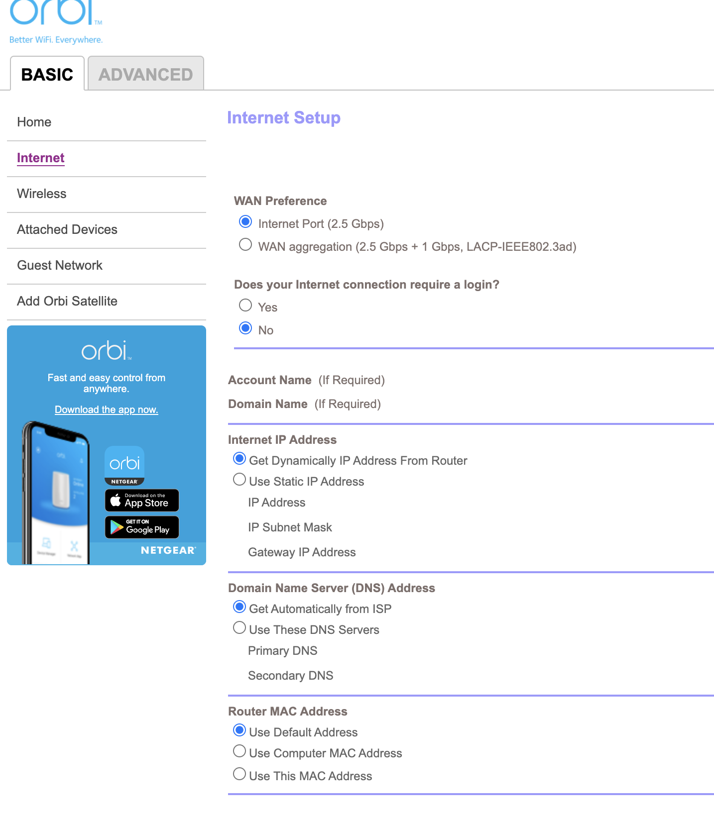

IP Pass thru on the ISP modem is not needed nor recommended if you have the Orbi RBR in AP mode. If your in AP mode then there is no firewall present if your using IP pass thru on the modem. You can change the Orbi to router mode then continue to use IP Pass thru. Then you can also change the RBR IP addressing scheme as well.
AP mode you can use either Dynamic IP addressing which the RBR in AP mode will get an IP address from the ISP Modem, OR, set a Static IP address while in AP mode ON the RBR, to some address that is outside of the ISP modems DHCP IP address pool, not with in the pool.
Gotcha, thanks for this info. I've changed my Orbi router mode and kept my ISP modem in IP Pass thru.Then you can also change the RBR IP addressing scheme as well.
So this is where I need help I think... Is there a recommended way to do the above and how is that done? Since putting the Orbi in router mode I can now get into the internet settings (see attached). I have not changed anythign there yet.Thanks again.
- michaeljritchieJul 21, 2021Aspirant
Attachment here...
