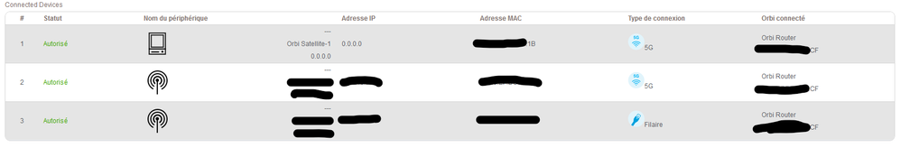

I can't connect my RBS to the RBR after changing to AP mode; the RBS led stay purple and they don't appear on the "connected devices" page.

Details: The 2 RBS have a continuous purple led and one of them appear on the device manager (with a 0.0.0.0 IP address and as a connected device, not a satelite)
    When in AP mode, does the RBK use their own subnet or they need a proper IP address (the RBR is behind a firewall with manual IP, which made me think that the lack of DHCP if the issue here)
    The Orbi system does depend on available IP communication, these are not "just" Ethernet switches, even in AP mode it's more than a pure Wireless<->LAN bridge - so without IP address it will be more than difficult, the sync can't work of course, too..
