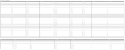

      Your power levels are all over the place, you have errors in the line, and your upstream is way out of spec.
      They need to come out and check their work.
