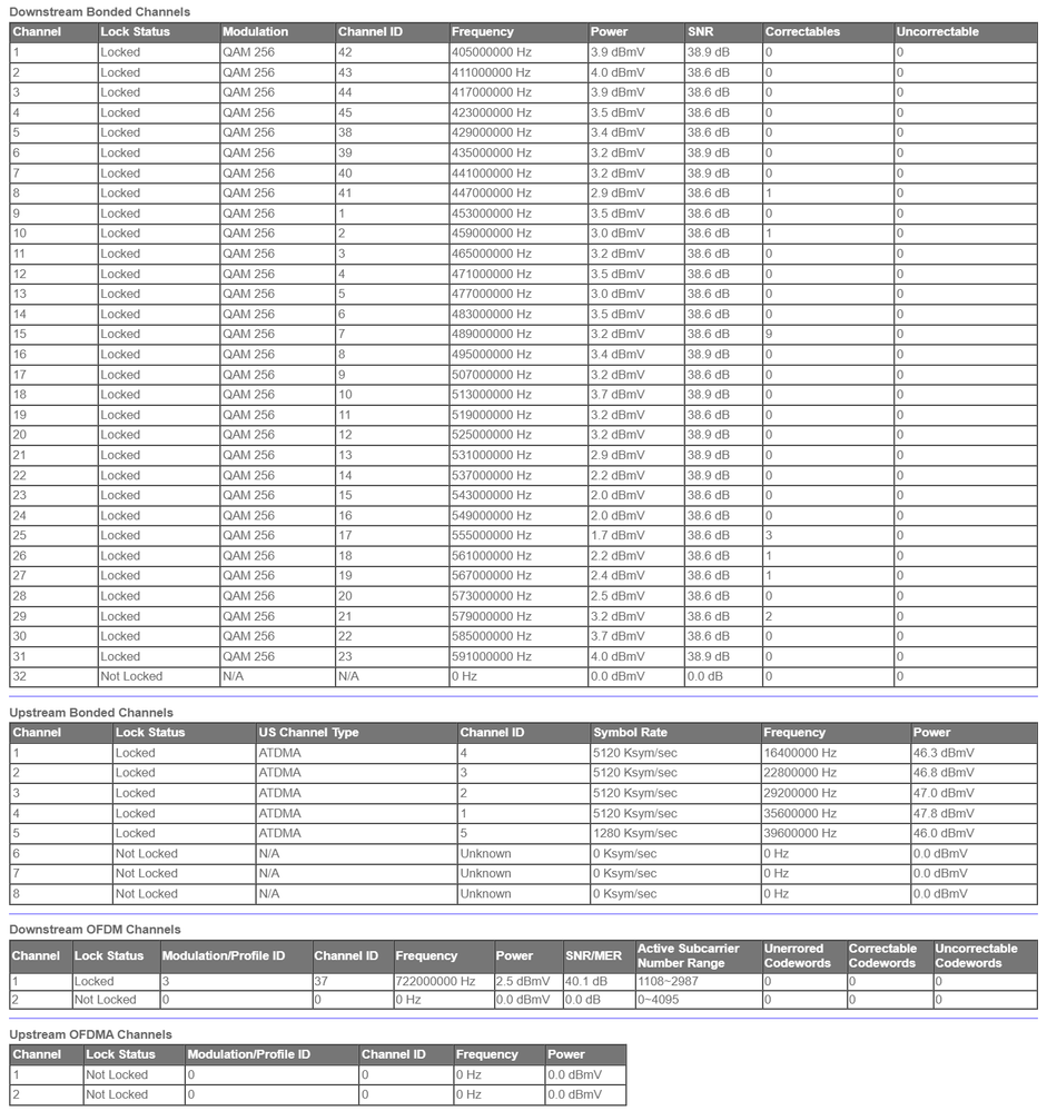

Do you have a screensnip of the cable connections page and event logs?
- GunnerpunkAspirant
These all look to be from the time I was initially setting up the modem, possibly before the firmware updated:
