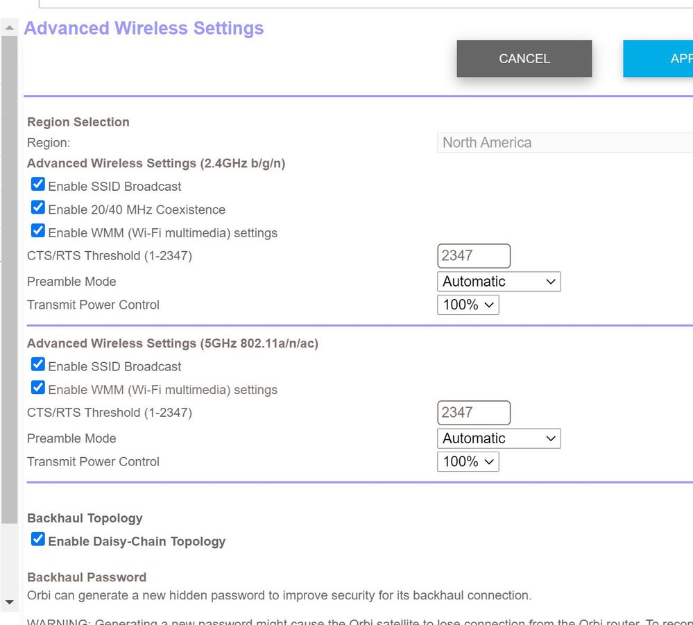

Frustrated...just spent a bit moving from my NIGHHAWK to the 'mesh' thing.
i have tried everything SHORT of RECONNECTING my old router and or extender
after spending time (so as you all dont waste your time)
I've tried it all, and some things I CANT NOT TRY..
unless im BLIND there isnt the abilty to DISABLE AM MODE (see below screen grab)
the CTS Values are all ready IDENTICAL
heres one I thought might work, (my idea)

  • solved my problem..yea me...
    had to reconnect  / reconfigure the OLD extender to get the garage to MYQ to recennect.
    then sfter connecting i reconfigured MYQ to see the ORBI network, which it did, and connected to the 2.4Ghz side of the ORBI
    removed the extender
    all is fine...
