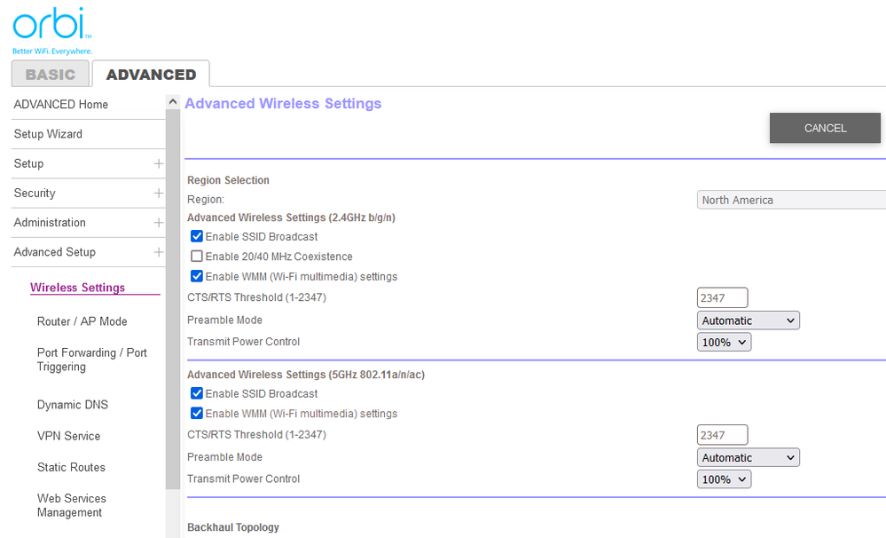

    I posted those instructions.  Here is where that option appears on my RBR50:
    However... I have eight KASA smart plugs, at least four different models, and they all connected to my RBR50 Orbi system without any fooling around at all.  KASA is my "go to" smart plug.

      CrimpOnThanks for the response. I too loved my Orbi (or will again once I can get the smart plugs working). I found the setting that you demonstrated in your screenshot. I turned it off and followed the rest of the steps but it still didn't connect. I just keep getting the message that Kasa was unable to connnect to my Wi-Fi Network after entering my Orbi password.

      • CrimpOn's avatar
        CrimpOn
        If the modem/router/WiFi is broadcasting a different 2.4G WiFi SSID on a different 2.4G channel, there should not be any interference with the Orbi WiFi.  (Although, most customers choose to turn off the modem/router/WiFi's WiFi radios if the device allows them to do so.)
