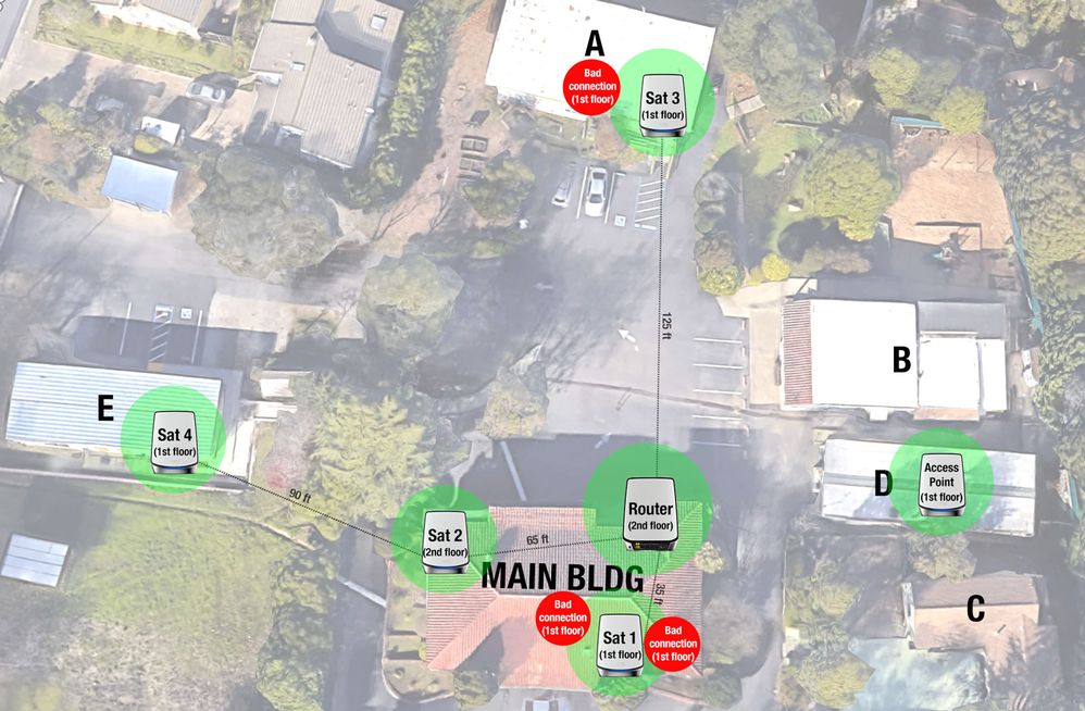

Our school is having an issue where devices in our mesh network are sometimes connecting to the distant Orbi router/base rather than the Orbi satellite that is right in the room with them a few feet away. Connecting to the distant router/base often provides very poor connection and super slow speed.  We have tried moving the satellites around to different spots, but the intermittent issue continues to occur.
We have 1 router (RBR840) and 5 satellites (RBS850), one of which is connected as an access point. All of them are on Firmware version V4.6.14.5
What should we do?  Is there a way we can we force devices to connect to the satellite near them rather than the base?

      Regarding the devices that are connecting to the router instead of the satellite nearby, they are Apple laptops that are essentially stationary throughout the day and then are taken home each night.  I have monitored them closely and they connect to the satellite nearby most of the time, but probably 30% of the time they just switch over to the router even though they have a very weak and slow connection to it.
      To provide additional detail, I have attached a map of our campus.  The red dots are where the problems are.  These locations are where devices are connecting to the router instead of the satellite that is less than 20 ft away from them.  Everywhere else, coverage is good and the mesh system works great.

      Here is a map of our campus with locations and distances of everything.  The red dots are the problem areas where staff are occasionally experiencing terrible internet.  When I take a look at what they are connected to, it is the distant Router instead of the satellite that is just a few feet away.  This happens about 30% of the time.
      I can try turning down the power output of the Router.  It is currently connecting to distant satellites nicely (125 ft line of sight) so I am a little worried that I will lose that distance, but I will see what happens.
      But still, it seems like there should be a way to make sure the devices connect to the satellite nearby which have a nice powerful signal in that area.  When they connect to the router, I can see that it has a super weak signal.  Any other insights, tips, or advice would be appreciated.

        So with users in Building A, those devices are connecting to the router in the main building?
        Might also turn OFF SAT1 in the main building. Possible too much wifi signal here.
        It's up to wifi devices to pick and chose where they connected too, even IF the signal maybe at a low level from the router.
        90 and 125 feet is possibly too far in distances...
        Let us know if setting 50% on the RBR changes anything.

      • The WiFi network is already completely operational when the Apple laptops arrive and are powered on. (or woken from 'sleep').
      • The laptops select the nearby satellite with a strong signal and connect.
      • After some period of time, the laptops abandon the stronger signal in favor of a much weaker signal from the router over 100 ft. away and performance becomes terrible.
      This just seems nuts.  My first thought is that (somehow) the laptops lost the strong satellite signal and switched to the router because it was the only signal available.  But, if the satellite signal returns, then the laptops should switch back.  (but they do not)
