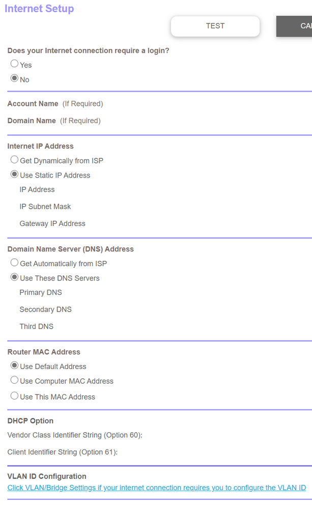

  • nickashfield on my Orbi RBK53 on Basic --> Internet I can see there are DHCP settings for both Option 60 and Option 61 (see the bottom of the picture below).
    I am not sure this is appeared with a recent firmware update but in any case NONE has been able to advise on how to configure the settings below for the Orbi to work as the PRIMARY router with Sky Broadband :-(
