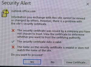

ERR_CERT_AUTHORITY_INVALID
Hi I have a recurring problem that happens every few months. Not a major problem given infrequent but is very annoying. I have Orbi RBR850s with latest firmware; Nighthawk 1G modem Internet wi...

The Orbi (RBK852) is currently connected to Netgear CM2050V (with firmware V2.01.03).
In the past I had it connected to Netgear CM1200 and had same issue come up a few times (but during first 12 months of same setup, it never happened).
The Orbi is on firmware V4.6.9.11_2.3.5 currently
RE: MS, my company's IT dept (it is company laptop) suggested updating drivers and BIOS on laptop which did have needed updates but I dont think those have been out of date the past year, so I am not sure that really explains it
- MM76Dec 01, 2022Aspirant
And forgot to add. Once i notice the problem and test other computers, i have the same private screen problem on them too, regardless of the browser type
