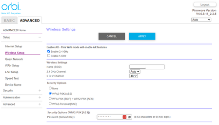

Can a mod move this to a more appropriate forum? The required "Labels" wasn't populating for me in the Orbi WIFI 6 (AX) AND Wi-Fi 6E (AXE) Mesh Systems so posting here in the hopes someone can redirect this to the correct place. Products RBR850 V4.6.9.11_2.3.5 RBS850 V4.6.9.11_2.3.5 Environments Windows 10 Pro for gateway changes iPhone 12 Pro Max for in app verification of changes Connected to Altice UBC1340 router configured as Bridge What's the problem? Like most folks, I have a mix of devices and some of them only support the 2.4 band. After reading the forums, I disabled the 5 GHz band and was going to follow guidance to connect the 2.4 devices first, and then re-enable 5 GHz. However, I didn't get that far. After disabling the 5 GHz band, I wanted to verify the Connection Type for the Satellite and strangely it still reflects 5 and not 2.4 despite 5 ostensibly being disabled. What am I doing wrong? What am I not understanding? Appreciate any help or guidance. Supporting Info 5 GHz band disabled Satellite on 5GHzSolvedORBi RBSE960 - Dead with no activity Light
