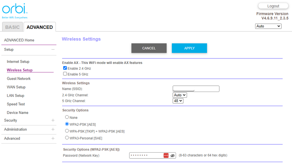

Like most folks, I have a mix of devices and some of them only support the 2.4 band. After reading the forums, I disabled the 5 GHz band and was going to follow guidance to connect the 2.4 devices first, and then re-enable 5 GHz.

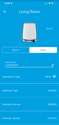

However, I didn't get that far. After disabling the 5 GHz band, I wanted to verify the Connection Type for the Satellite and strangely it still reflects 5 and not 2.4 despite 5 ostensibly being disabled.

5 GHz band disabled
Satellite on 5GHz
The Check box next to 2.4 and 5Ghz is for AX MODE, that disable or enabled the AX mode operation over 2.4 or 5Ghz or both. It does NOT disable the actual radios.
Your behind on FW.
If you need specific configurations for IoT devices and need only 2.4Ghz, then you'll need to update to v7.2.6.21:Then you'll have the ability to set up a separate IoT network for your devices.
https://kb.netgear.com/000064267/How-do-I-enable-or-disable-the-Internet-of-things-IoT-network-on-my-Orbi-WiFi-6E-System
https://kb.netgear.com/000064269/How-do-I-change-the-Internet-of-things-IoT-network-name-SSID-and-password-on-my-Orbi-WiFi-6E-System
Your behind on FW.
https://kb.netgear.com/000064269/How-do-I-change-the-Internet-of-things-IoT-network-name-SSID-and-password-on-my-Orbi-WiFi-6E-System- jwdavistxAspirant
Thanks so much for the quick and detailed response.
I've completed the Firmware update, and will be following-up on the configuration of devices.
