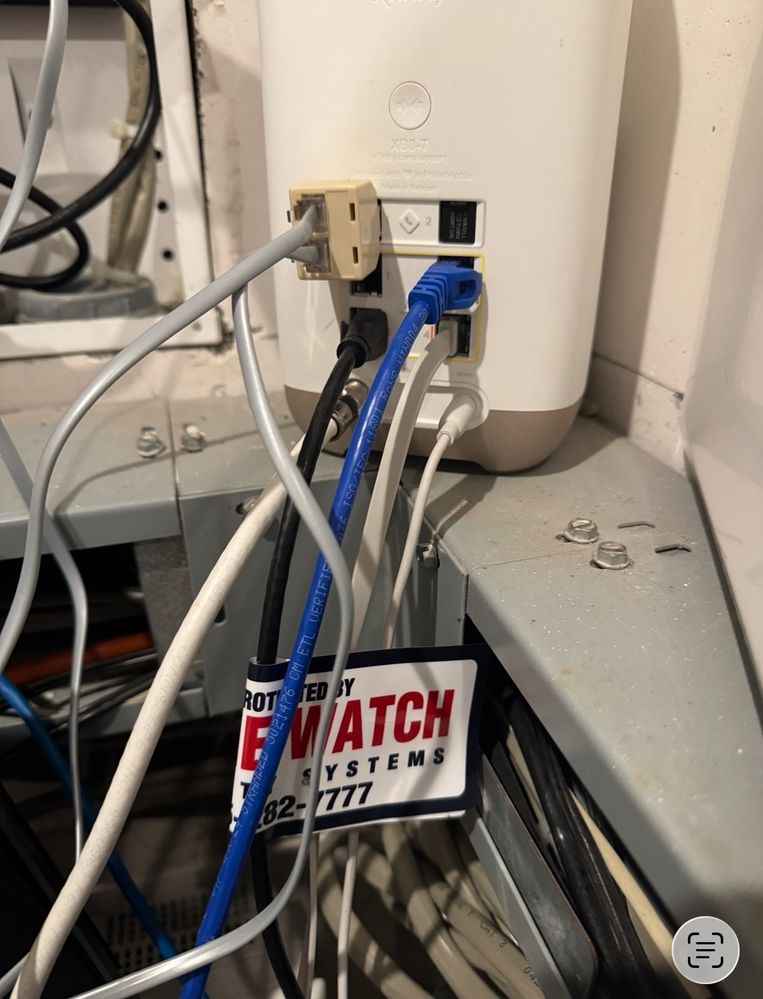

- The Orbi router’s “Internet” port connects to the XB8’s port 2
- The Orbi router’s “2.5 Ethernet” port connects to Switch #2’s port 16.
- The Orbi router's “Ethernet port 1” port connects to Switch #1’s Port 16.
- The distance between the router & RBSes varies (from 12 feet to 40 feet to 3 stories above).
- I also have a phone line, coax cable, security system plugged into the XB8.
