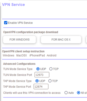

    OpenVPN is not a web service.  (at least on the older model Orbi) OpenVPN host is configured to listen for connections on ports 12973 and 12974.

      well i had moved mine to 443. it always worked and openvpn actually listens and  redirects https traffic as a proxy to the httpd, and processes vpn traffic itself.
      It does not work properly on 4.6.8.2 and is the reason 4.6.8.2 breaks admin access for others.
