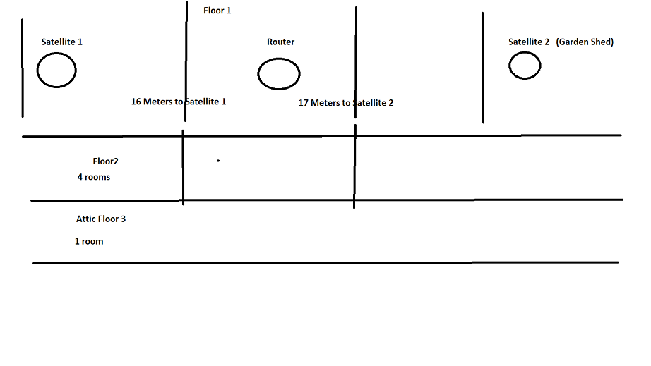

    • x19's avatar
      x19
      Guide
      Hi Iyang
      I have Armor enabled, Parental Control Disabled, Traffic Meter Off,VPN Service Off.
      Minimum 30 devices connected, with a peak of 45-50 some days.
      I also attached a picture with proper layout of physical deployment.
      Also Netgear switch connected to Orbi Router and POE Switch connected to satellite 1.
      These are beta units from the last Netgear project.   This is the first reboot I have experienced since I got the units.
