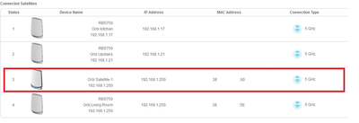

A new RBS 750 has appeared on my system (RBR750 plus 3 RBS750s all on wireless backhaul) and I don't know how. It appears to be a duplicate of another satellite (with a two digit different MAC address and completely new serial number) and uses the same local IP. In the image below, the 3rd one is the new ghost satellite and the 4th entry is the one it appears to be duplicating - although the duplicate seems to have no attached devices, whilst the original has wired and wireless clients.
It appeared from nowhere - I was cooking at the time when I got a notification from the app on my phone that Armor had discovered it and now a lot of other devices on my network are suddenly being "discovered" and scanned by Armor again, resulting in lots of duplicate devices in "Attached Devices" and the Device Manager. I've not touched the setup of the network for months - although the router and satellites did auto update last week to 4.6.9.11_2.3.5, so am at a loss to as what is going on.
After it first appeared, wifi speeds did initially plummet from about 700Mbs to 25Mbs but a reboot solved that, although the duplicate persists. It shows in both the iOS app and the full web admin client.

        Oddly, having left it for 24 hours the “ghost” satellite has now begun showing as disconnected allowing me to remove it in the admin.
        As mysteriously as the problem begun, it’s now mysteriously given me a way of fixing it - despite zero changing!
