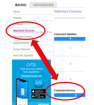

    This is on the web browser interface, Attached Devices screen, correct?

    I remain confused by terminology.  Netgear helpfully chose to use two different terms to describe devices:
    • The web browser interface uses the term "Attached Devices", and
    • The Orbi 'app' uses the term "Connected Devices"
    You are using the web browser interface, correct?
    • FURRYe38's avatar
      Actually on the RBR web page it's Connected Devices. On the Orbi app its Device Manager/Devices online.
      • CrimpOn's avatar
        CrimpOn
        Thanks for catching the error:
        I am so easily confused!
