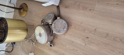

3. For devices that need 2.4 connection and you can't move the device (garage door 🙂 ), you have to block the antenna so the router is forced to use the 2.4. I had to get creative and it worked. I laid the main router on the floor and put multiple metal pots and pans over it.

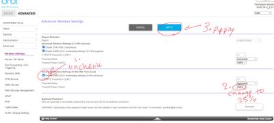

4. Follow these steps. Under advanced, advanced wireless setting, uncheck enable WMM advanced 5ghz and change the 100 to 25. Then click apply.

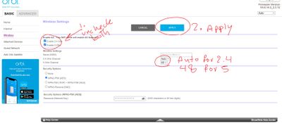

5. Under Basic. Uncheck both Enable AX 2.4 and 5. Put the 2.4 on Auto and 5 on channel 48. Apply.

8. Do the above steps in reverse. Enable AX 2.4 and 5. Apply.
Under advanced, advanced wireless setting, enable WMM advanced 5ghz and change the 25 to 100. Then click apply.
Remove the pots and pans lol; stand up the router. Plug in the satellites.
