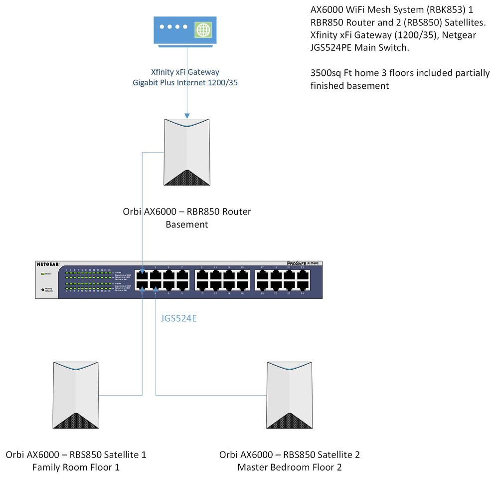

AX6000 WiFi Mesh System (RBK853) 1 RBR850 Router and 2 (RBS850) Satellites. Xfinity xFi Gateway (1200/35), Netgear JGS524PE Main Switch. Wired Backhaul to Main Switch.
This is similar to the issues raised by Rogelio1
https://community.netgear.com/t5/Orbi-WiFi-6-AX-and-WiFi-6E-AXE/iPhone-12-Pro-loses-WiFi-connection-with-RBR850/td-p/2239312
Slightly different but hopefully not unique.
My iOS devices, three iPhone 13's and an iPad have Internet issues only when connected to the main router located in the basement. They exhibit either extremely slow internet speeds or no internet access at all.
When they are connected to either satellite, I have no issues. It's problematic because my home office is in the basement and the main router seems to be the one most likely to grab devices that are outside.
Thoughts?? Basic map attached.

      1. FW - 4.6.9.11_2.3.5
      2. It is an xFi Gateway from Xfinity
        1. Model:CGM4140COM
        2. Vendor: Technicolor
        3. Hardware Revision:2.2
      3. Cable's are fine, green features disabled, but likely irrelevant since the Router is before the switch.
      4. Dumb question but will turning down the power impact throughput speed?
      5. They are all kind of stacked on top of each other floor to floor, (almost directly above each other on each floor) so max definitely less than 30 feet between them. But again might be irrelevant since I am using Wired Backhaul
      6. All the Apple stuff disabled.
      I have read many posts on this, this seems isolated to the RBR only. The devices roams fine. If I go upstairs and it roams to the 1st floor satellite, boom, problem solved.

        5. They are all kind of stacked on top of each other floor to floor, (almost directly above each other on each floor) so max definitely less than 30 feet between them. But again might be irrelevant since I am using Wired Backhaul <Distance in between, regardless of wireless or wire connected IS relevant. Less that 30 feet is too close to each other. Try turning OFF one RBS and see how things work. Too Much Wifi: https://youtu.be/UR0viMLISz4
