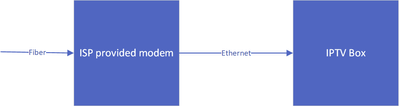

I have an issue with the IPTV box connected in my system. Ideally, the ISP provided setup should look like this:
How I have it connected:
Right now my gateway and the access points are the Netgear Orbi RBK853 (1 main router + 2 satelites). It takes quite a while (in physical cables terms) for the ethernet connection to reach the IPTV box, since starting from the Orbi gateway there is a satelite (access point) and a switch (not drawn here). So the easiest solution, to connect the IPTV directly to the ISP provided modem is not possible for me.
How to configure the gateway (if even possible), to somehow forward the packets from the ISP provided modem directly to the IPTV box without the NAT network created by the gateway, so the IPTV box gets assigned with an IP from the 192.168.1.x range (by the ISP provided modem), instead of 192.168.7.x (Orbi gateway). The ISP provided modem has an IP of 192.168.1.1 and provides DHCP range from 192.168.1.2 to 192.168.1.100. The Orbi router has its IP set to 192.168.7.1 and works in DHCP range of 192.168.7.2 - 192.168.7.200. I think for the IPTV its not really about the exact range, but rather being connected directly to the modem.

    Not aware any Orbi system does support IGMP Multicast and IGMP Snooping, neither on the router alone, nor over the wireless (or wired) backhaul to an Orbi satellite. While the Orbi Pro does support VLANs, there is no IGMP support to my knowledge either.
    Said this: It's extremely difficult to substitute an ISP supplied router which does seamless integrate the ISP Internet connection and the IPTV VLANs. The only option is to design and implement a multi-VLAN switch infrastructure handling the Internet (and it's LAN) and extend the IPTV VLAN accordingly.
