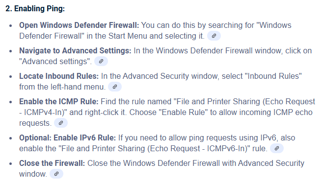

        Windows computers have elaborate firewall settings with one set of rules for the local (private) network and another set for the remote network.  By default, Windows computers do not respond to ICMP requests ('ping')
        Most of the 60-odd devices connected to my Orbi system respond to ICMP, but there are some "odd balls" that do not.  The Echo Dot speaker, for example, does not.
