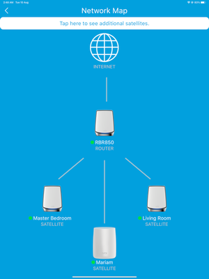

Hi,
I have an RBK853 and an RBK53. I setup the RBR850 as the main router, 2 RBS850s as AX satellites, 2 RBS50 as AC satellites, and I also connected the RBR50 as a satellite.
The RBR50 shows up on the Orbi app as a 5th satellite, and shows as successfully connected.
Each satellite is in a separate room, connected to the RBR850 router with wire ethernet cable.
1) I cannot turn off/hide the RBR50's SSID broadcast.
2) When I am in the room of the RBR50, the iPhone/iPad connect to the other units, unless I choose the RBR50's wifi, not the RBR850's.
It looks like the RBR50 is showing up as a satellite in the RBR850's network, but it is not actually behaving as a satellite.

      But the RBS50s are working perfectly with the RBR850, same wifi name, no problems at all.
      My issue is specifically with the RBR50.
      So it's an RBR issue, not a 50 vs 850 issue.
