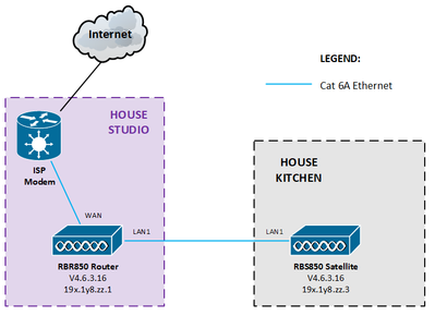

I have a set of a RBR850 Router with a RBS850 Satellite. They are connected via Ethernet Cat6A cable, as shown in Figure 1.
Figure 1: Network Diagram

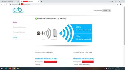

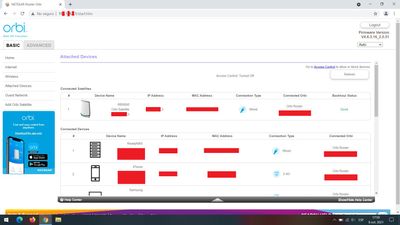

Normally, the system will detect that both devices are connected via Wired connection, and the connection is ok (with the status as "Your WiFi Orbi Satellite is up and running" message), as shown in Figures 2 and 3.
Figure 2: Connection frtom Router to Satellite
Figure 3: Normal Satellite Behaviour

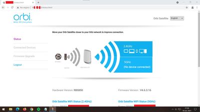

But every now and then (every couple of days or so), the connection with the Satellite seems to drop and the Satellite won't work. When this happens, the system detects that both devices are connected via Wireless connection, and the connection is failing (with the status as "Move your Orbi Satellite closer to your Orbi Network to improve connection" message), as shown in Figure 4.
Figure 4: Satellite Error message

      Are the RBS directly ethernet conencted to the back of the RBR or is there a LAN switch in between?
      Answer: They both are directly ethernet connected. No other LAN devices in between.
