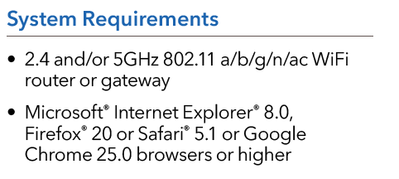

    It is not clear to me that the EX8000 is capable of functioning as an Orbi satellite.  The EX8000 is  inherently a generic WiFi extender.  Notice that the Product Data Sheet on page 5 mentions the only requirement as "WiFi router or gateway"
    Unlike the RBS50Y and RBS40V which have different firmware versions for Orbi satellite and Extender modes, the EX8000 has only one version of firmware.
    When the EX8000 is connected to an Orbi AX system as an extender, it will appear in the Attached Devices list as a device. (because it is not a satellite).  Even though it may have the same SSID/password as the primary Orbi system, devices may have trouble roaming between the primary WiFi network and the EX8000.
    If the goal is to extend WiFi coverage to devices which remain in one place, the EX8000 appears to be a fine WiFi extender (although a bit on the expensive side).
