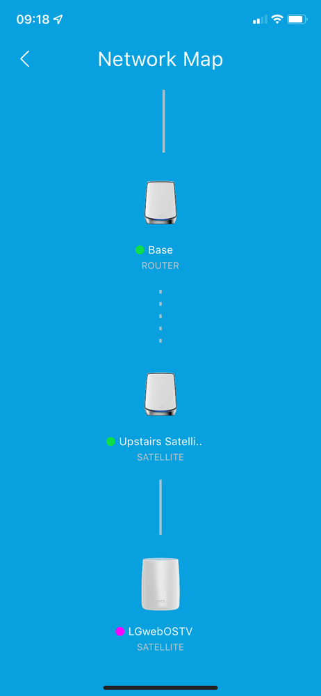

I have an Orbi model RBR750 with one satellite, and I have a connection problem. The main problem is that the LG TV cannot connect to Orbi's Wi-Fi network. The second thing, which is an observation, is that on Orbi's network map, the LG TV appears as a satellite (connected to the actual Orbi satellite). So I'm puzzled as to why Orbi thinks the TV is a satellite, and I suspect it could be related to the problem of the TV connecting to Orbi's Wi-Fi network. Is there a way to tell Orbi that the TV is not a satellite? I would like to try that and see if I can then get the TV to connect to the Wi-Fi network.

Thanks for your help. Changing the CTS/RTS Threshold fixed the problem. It's connecting now.
The LG TV still shows as a satellite, but that doesn't bother me as long as it connects.
