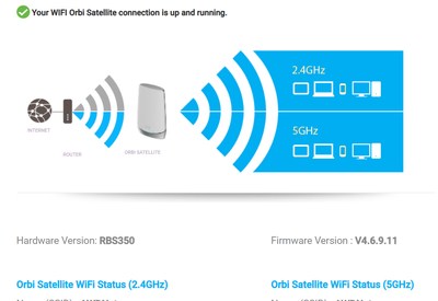

      My RBS350 says that it now has the firmaware v4.6.9.11 (please see screenshot below), but I still don't see any reference for this version for RBS350?
      • FURRYe38's avatar
        v.29 is posted on NG download site for manual download. It may not be seen on the RBRs FW update web page as NG may not be giving notifications for it yet. If you want v.29, you'll need to manually apply this version.
