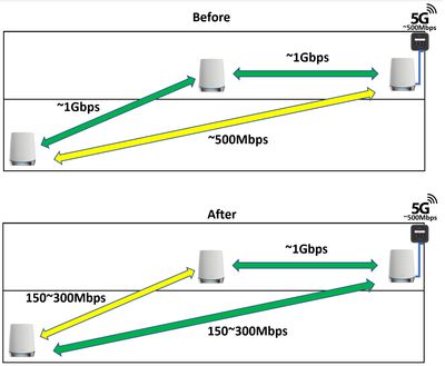

  • Upgraded my RBK753 system, and now the wireless daisy chaining doesn’t work correctly. I have the router and two satellites almost in line, before the upgrade the last satellite always connected to the middle one, but now it always connects to the router directly, sometimes over 2.4Ghz 😠. I didn’t change the location of any of the nodes, just upgraded the firmware. I feel like going back to the previous version, but the last time I installed that version I had to reset everything and start from scratch which I don’t want to do.
    If anyone out there is daisy chaining their satellites think twice before upgrading to this version.  This is so frustrating, they fix one thing and break another. Why can’t they allow controlling daisy chaining manually? I see a lot of complaints about the daisy chaining not working right from the first generation Orbis, why can’t they get the logic right after all this time? 😡
    • For your size of home, you only really need 1 RBS.
      Did you first turn OFF the RBR and RBS for 1 minute then back ON after the FW update was applied?
      Did you turn OFF the RBS then back on with the closest RBS to the RBR and let it fully sync then turn on the farthest RBS?
      Also try turning down the power output of the RBRs wifi radios from 100% to 50% and see if this changes anything. Under Advanced Tab/Advanced Settings/Wireless Settings
      Might update your original thread:
      https://community.netgear.com/t5/Orbi-WiFi-6-AX-and-WiFi-6E-AXE/Daisy-chain-wireless-backhaul-performance-RBK753/m-p/2229529/highlight/false#M33689
      • O_F's avatar
        O_F
        Guide
        I understand that I can get by with just 1 RBS but it was working a lot better with two satellites before this update.
        An update should make things better not worse.
        Yes, when I restart the furthest RBS it sometimes connect to the middle one for a while but switches back to the RBR in few minutes. This didn't happen before the upgrade.
        Tried it too, but didn't help much. At a lower power level the daisy chain remained for longer, but after a period of inactivity I saw the furthest RBS connected to the RBR over 2.4Ghz. When daisy chained over 5Ghz at reduced power I was getting 300~400Mbps between the two RBSs (slightly better than the star configuration at full power) but when it switched to 2.4Ghz I was getting less than 200Mbps.
