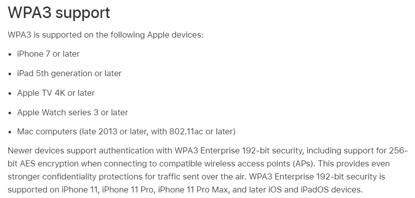

  • OK. I finally updated my Orbi RBK753's firmwares v4.6.14.3 to v7.2.6.21 manually (2 satellites and then its router one by one slowly). Things seems OK so far after 30 mins. I didn't enable its new IoT feature since I don't have any IoT devices. I noticed the new wifi security options for WPA2-PSK [AES] + WPA3-Personal [SAE]. Finally.
    Questions: Do wireless devices use the (new/high)est WPA3-Personal [SAE] over WPA2-PSK [AES]  by default if supported? Also, is there a way to tell which WPA security connection the devices are using like in iPhones (6+[iOS v12.5.7] to 13), iPad Air (original), Apple TVs (3G & 4K), Intel MacBook Pros (2008 with El Capitan v10.11.6), 2012 (Mojave v10.14.6), and 2020 (Ventura v13.6.1)), OfficeJet Pro 8028e inkjet color printer, etc.? Is there a way to do all three (WPA-PSK [TKIP] + WPA2-PSK [AES] + WPA3-Personal [SAE]) if wifi devices will pick the (high/new)est secured wifi connections with Orbi?
    • FURRYe38's avatar
      Orbi only supports Mixed Mode WPA2 and WPA3 or WPA2 only modes. TPIK is considered older mode and is also compromised. Use only if really needed. Recommend WPA2 and WPA3 mixed mode. Have not had any problems with this since NG finally put this mode back in.
      • ant's avatar
        ant
        Prodigy
        Wow, quick answers. Thanks. So far, WPA2-PSK [AES] + WPA3-Personal [SAE] seems to work with very old hardwares like 2008 MBP (El Capitan v10.11.6), iPhone 6+ (iOS v12.5.7), and original iPad Air (v12.5.7). I am going to assume they're using WPA2-PSK [AES]. I hope I don't have anything older that require WPA-PSK. I wished there was a way to see which wireless secured connections are being used in real time like in the router or even on client side.
        What are your oldest connected wifi devices you have with this Orbi model?
