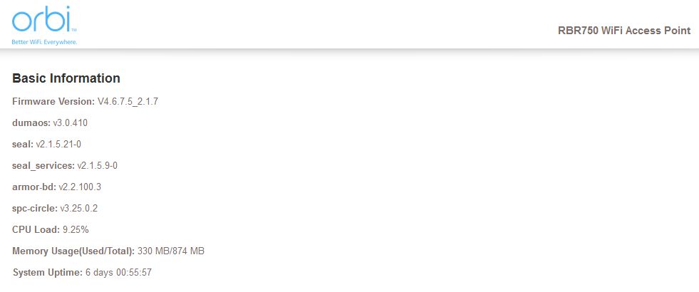

Hi all
If it helps for comparison purposes, here is my ORBI debug info showing CPU / Memory usage with this latest FW. I've checked this over the course of the 6 days that the system has been up (recently powered off as I improved the location of the RBR and RBS units, and then wired in the backhaul). But seems pretty constant at 9% CPU and 330MB.
All my devices are wireless in the property. I sometimes have (especially from the office) x1 PC, x2 Laptops, x2 Printers, x3 Mobile Phones all on the go. And then in the property we can also have x2 TVs with x2 PVR recorders using x2 AVRs for home cinema, and a security camera all connected as well. So nearly x15 devices. That might be small... but to me that seems like a lot of things. :smileytongue:
I also have "IPv6" disabled and "Known DoS attacks and Port Scans" from within Logs - as I read a post on these forums to disable that to help with resource usage. I use my RBR in Router Mode as well, along with Armor security enabled.
Hope this is useful.

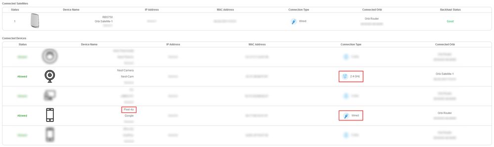

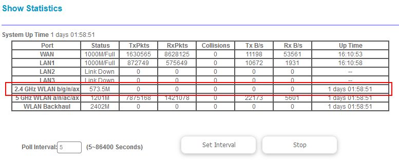

Hi all
Looks like I definitely have a werid 2.4Ghz glitch / bug with this firmware but thankfully it is easy to resolve. Recently had a power outage and that seems to have caused the bug to reoccur. A simple power down, leave for 2 minutes, power up RBR and then RBS seems to iron out the kink. But this is what I have at the moment (pre-reboot).
- Device List shows the wireless camera connected on 2.4Ghz to the RBS. Note however in the screenshot the RBR reporting zero data transfer on 2.4Ghz channel. All other devices are choosing to connect at 5Ghz.
- Device List shows one of the mobile phones, as "Wired". Tried deleting it from the Orbi and switching the phone off for a few minutes. Reconnects and shows exactly the same.
Not a major deal for a beta FW but thought I'd just raise it for awareness.
Thanks
Has a factory reset and setup from scratch been performed since last FW update?
