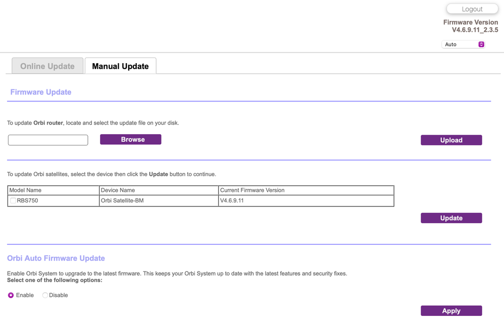

Applied this fw yesterday (updated from 4.6.8.5)
I did not have any issues with 4.6.8.5, but i liked the option to disable automatic updates just so you can plan your updates rather than an update happening just before F1 race (for example)
First i could not find this option in the new fw, but it is "hidden" in the advanced/Administration/firmware page but strangely enough on the "Manual update" tab..
I performed the update by individually updating the RBS satellites one by one, I waited for every satellite to complete and connect to the RBR again before going to the next. Finally updated the RBR. the whole process took about 20 minutes (4 satellites, 1 Router). I did not power cycle anything before, during or after the update.
Finally also disabled the log emails.
- kevin242Aspirant

My RBR750 Main/Satellite upgrades went fine, but where do I now find the new auto-firmware upgrade enable/disable feature option? Thanks.
Review the first post...
