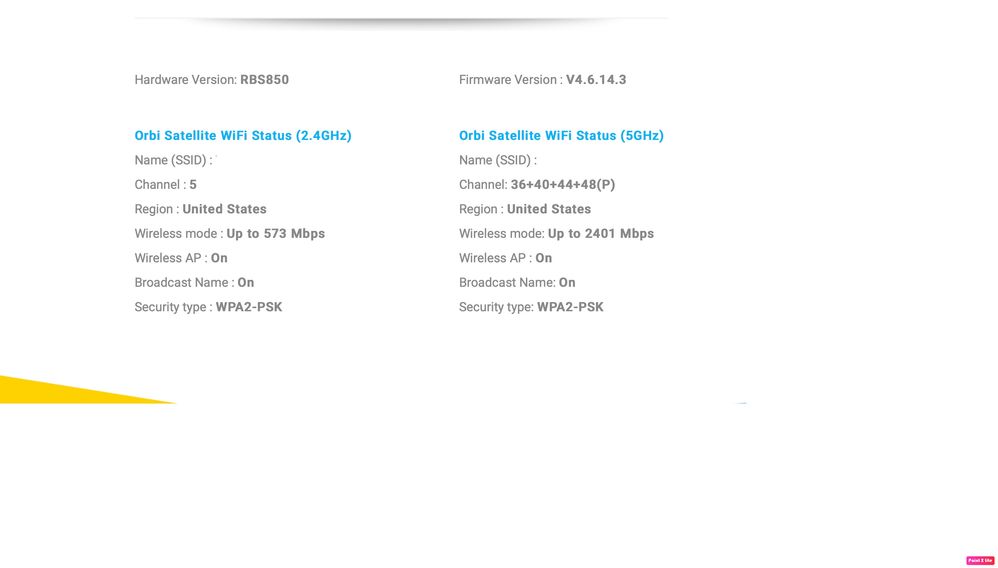

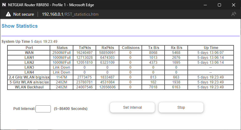

Updated. Strange to see the Satellite report 2.5G network is up to 573 Mbps instead of the 1147 Mbps it used to say. The Router still lists 1147. In the past the Satellite reported the same as the Router.
The other thing that was strange in my process was the Firmware update page stated there was an update on the Router but not the Satellite. I manually updated after downloading the files and performing it on the Satellite first.
Could you post a screen shot of the satellite showing speed information for the 2.5G port?
- N3tworkDud3Apprentice
Sure - here you go:
